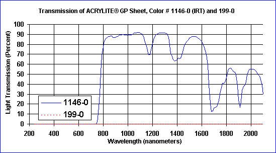

Просто первая попавшаяся ссылка, да и то ради графика пропускания: http://www.plasticgenius.com/2011/05/infrared-and-ultraviolet-transmission.html
Вот чёрный там упоминается.
But wait, there's more! Here's the special grade of Infra-Red Transmitting sheet. It is BLACK in color, but allows the IR to transmit through. Very cool for spy related video equipment. Available in 1/8" and limited amounts of 1/16" thick.
1146 is the IRT and 199-0 is opaque black.
