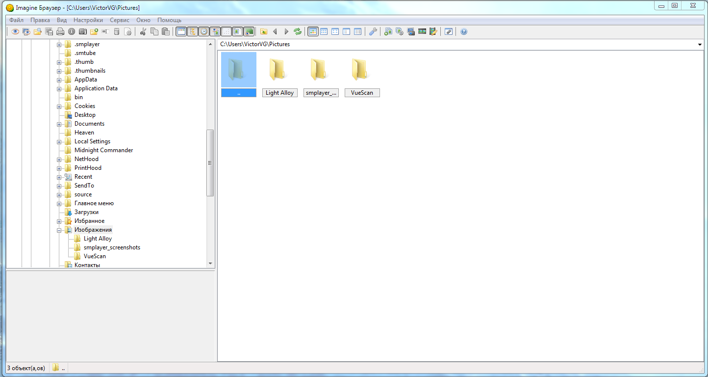

     - Fixed: When loading a small image, the menu appears in two lines
