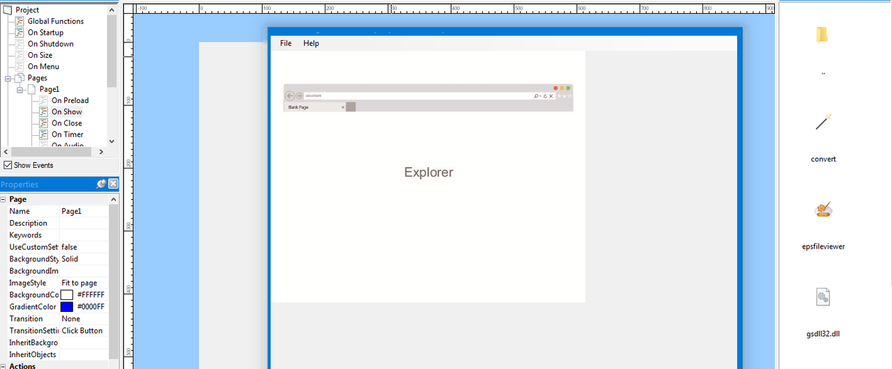

    usamakey
    @Dnevic
    I don't think there is a plugin or dll that performs this function in AMS.
    There may be an alternative solution embedd the EPS File Viewer program into your project.
    https://i.postimg.cc/GtmBjzLg/screen.png
    Всего записей: 77 | Зарегистр. 01-03-2019 | Отправлено: 14:11 29-09-2023 | Исправлено: usamakey, 14:13 29-09-2023
